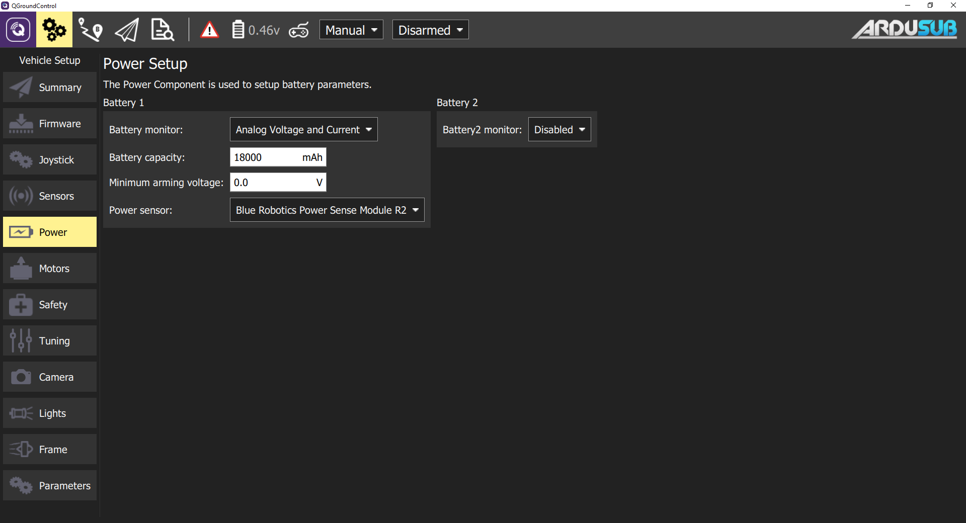

Quick Start
1. Follow the PSM installation instructions if installing or retrofitting a BlueROV2.
2. In the Power tab of the QGroundControl Vehicle Setup page, select “Blue Robotics Power Sense Module” for the Power Sensor.
